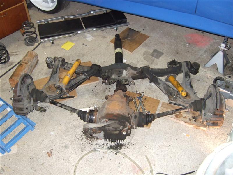

« Reply #132 on: 24-Sep-2010, 22:12:58 »
Sadly my total mileage this year with the m3 was zero :(. I thought to myself I do it the right way and instead of doing a quick fix and driving the car for 2month until the winter arrives Ill
do it the right way and renew/improve alot of things now.
I finally removed the rear axle completly to discover that the dampers are completly collapsed which I did not notice before.
You can see on the picture that when I fully compressed them they did not return into normal position.

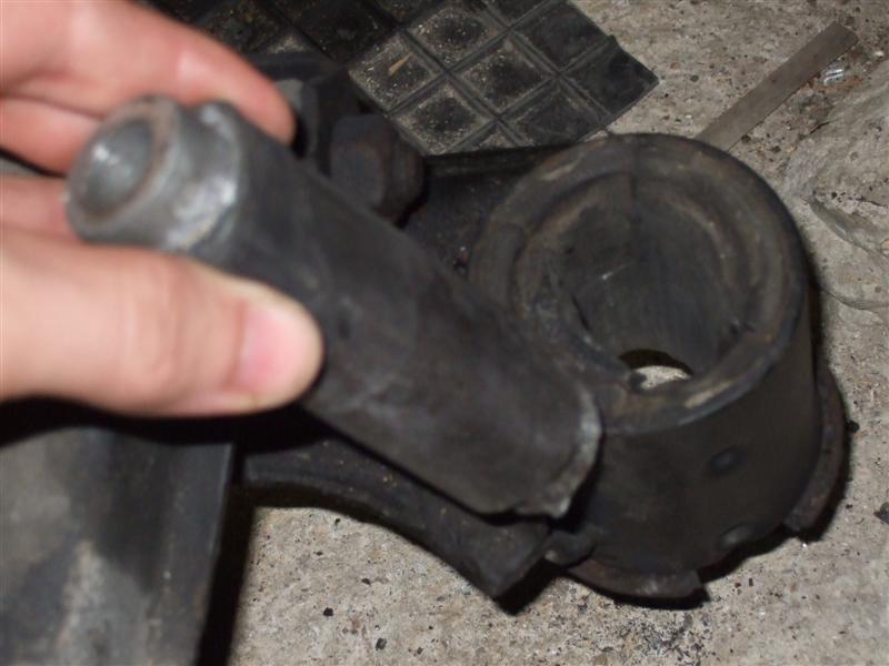

Main reason why I dropped the axle was because those rubber bearings on which the axle is mounted were fucked up. Getting those out with the axle still on the car is possible but a nightmare.
The combination of aluminium core of the bushing + steal car + alot of pressure from the car + contact corrosion makes it quite hard even with special bmw tool to get it out.
So I dropped it complete to have more comfort when getting the old bushings out.
Normally this is one piece :D
my new wheels for the winter time - because I want to avoid having the car on axle stands all the time
One worried Phobo - will the car ever be complete again? :D I hope so
plan for the next months:
install fresh stainless steal brake pipes,
install fresh polyurethane bushings
install new upgraded differential cover + fluid change of course
renew brake calipers
powdercoat the rear axle
maybe add some plates plus excentric screws that I can adjust camber and track
reinforce rear axle
upgraded strut bearings
new e-brake cables
reinforced anti roll bar mounting point
and thats only the rear axle but I hope to finish that first.
