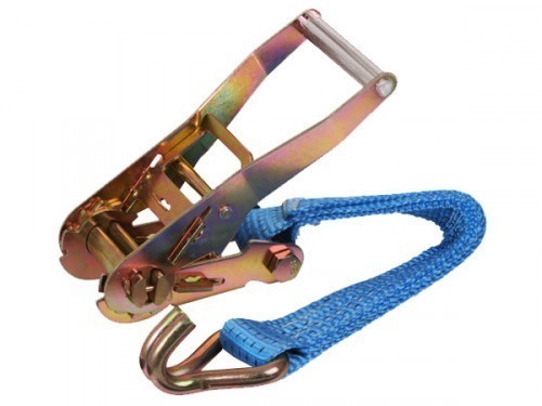

Is it possible to remove the complete suspension strut without anything to compress the spring, or will it go ping? I want to get the hubnuts undone and I was thinking I could just take the whole lot off and go to a garage and see if theyve got an impact wrench that would do it or something.

On the suspension I would say you look at a ping if you dont compress the spring.... ;)

In your case I would buy a simple spring compressor like this:
Not very expensive I got mine for ~15euros
Or you do it the redneck style with a quality ratchet strap (watch out depending on your car the spring still can be highly compressed)
Looks like a couple of those will be going on the shopping list then. Will come in handy though as I'd like to put some lowered springs that came with the car on as the fronts sitting ridiculously high at the moment with no engine.
